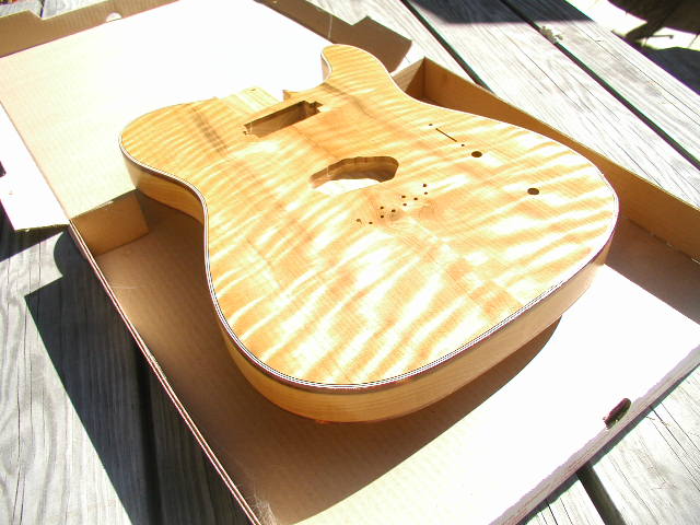

After becoming a French Polish convert, even for my steel strings, today's job seems so retro - a little rattlecan nitro job!

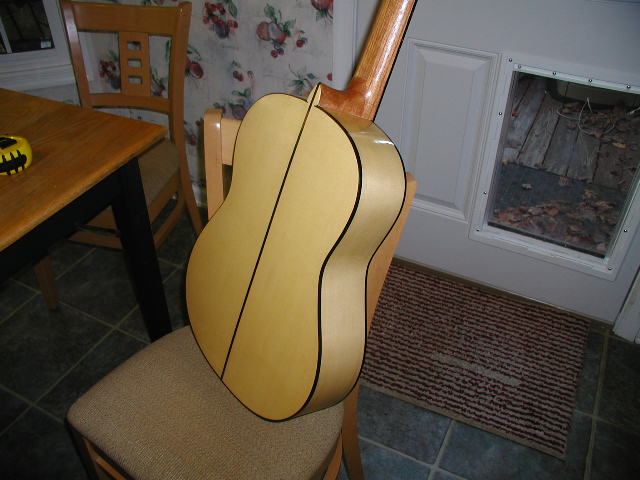

Another guitar is getting it's finish too - something a little closer to my present norm
This flamenco has been really dragging. It was supposed to be done less than a month after my classical #2 this summer, but here we are polishing at end of September - bridge still getting shaped too. Too busy at work!

nice!
is that yellow cedar on that "blanca"?

Yes, yellow cedar, ebony bindings. It has a carpathian spruce top, BRW headplate and bridge. Wish I had done BRW bindings to match. Next batch!

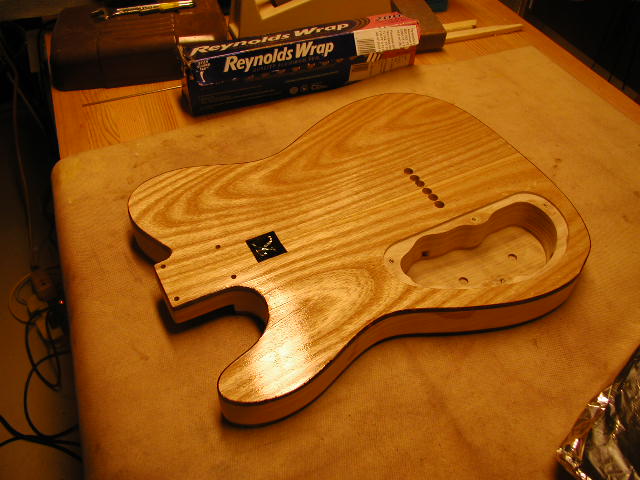

Waddy - Not too many - here's one of the Tele with it's Z-poxy fill on the ash back, which is going to be natural. The cover for the cavity was sawn from a slice taken off the main body, and matches the rest of the back pretty seamlessly. I don't hav a better picture of the top - it's flamed myrtle that I cut from a board I got at a local supplier. I have 4 back and side sets from the same board waiting.

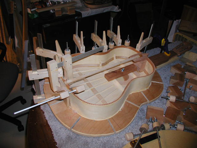

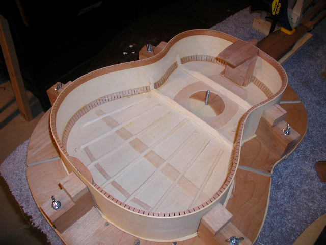

For the Reyes-style flamenco - here is a pic during he glue up that shows the bracing. It's been fun building these (I have two in progress) - they are light as feathers and it is easy to see how they get their quick attack and quick fade - the bodies are really loose feeling and I'm sure very lossy. I can't wait to string one up and see.

Just curious what is the little traverse fingers near the end block for?
It looks interesting.

Sen - I'm not sure why the little fillets in between the ends of the fans are included. It's some sort of partial closing brace, which a lot of flamencos don't have - it may have been put there on the particular guitar being copied in response to properties of that particular top. I don't know if Reyes uses them all the time or not. (and I don't know enough yet to tell whether to include that sort of thing or leave it out.)
Udi - This will be my first finished blanca, and so I don't know if I like it or not! My first two finished classicals were based on a Miguel Rodriguez Jr guitar (Blackshear again). This design seems to be easy for a beginner to build - it produces a pretty well balanced instrument even though the body is very large.
My next batch are going to be based on the 1973 Romanillos of Bream's, although I'm building several (to test material combinations) and one is going to have a pretty standard Torres pattern. I hope at that point that I'm beginning to get a sense of what is going on.
